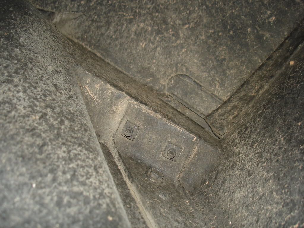

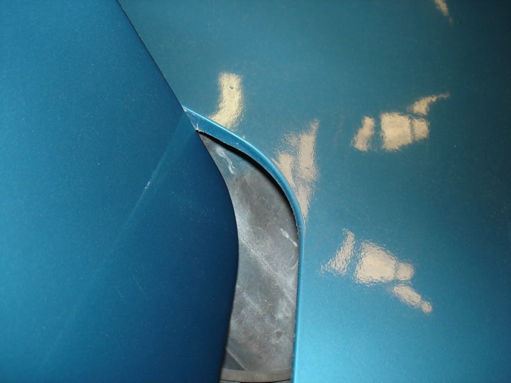

    Even after almost 40 years of working on these cars, I still find things that I have never noticed before. I was poking around a very original bodied `68 in the shop today and found a factory fix that I have never seen. Now, we all know about the `68 body problems and their tendency to sag at the front hood corners.
    This area:

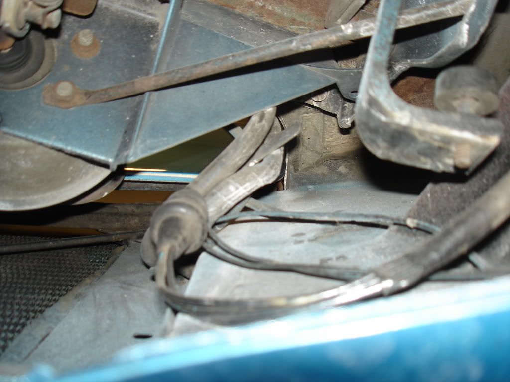

    I am sure that they realized they had problems in this area rather early on, and by 69 had installed metal brackets at the end of the header bar.
    On this car, serial number in the 25XXX range, the factory cut down two of the fiberglass brackets that are mounted beside the HL openings and glued them to the upper surround. They sawed a notch in the inner fender to allow it to pass through. Anyone else seen this one?

    Wayne
    I don't have it on my April 18 built body.
    John

      Sorry to be off topic Wayne but is that original paint and if so, is that what typical production paint(orange peel) looked like?

        Hi John
        If your April 18th car doesn't have it. I wonder if any May 68 owners have it and if so early mid or late May 68 cars had it. If not then any one with a June 68 car has it??
        I judged a July 68 L89 survivor 17K mile car and it was serial number 24XXX
        and it has the fiberglass bond.
        Thanks, grant

          No, It has had an overshoot.
